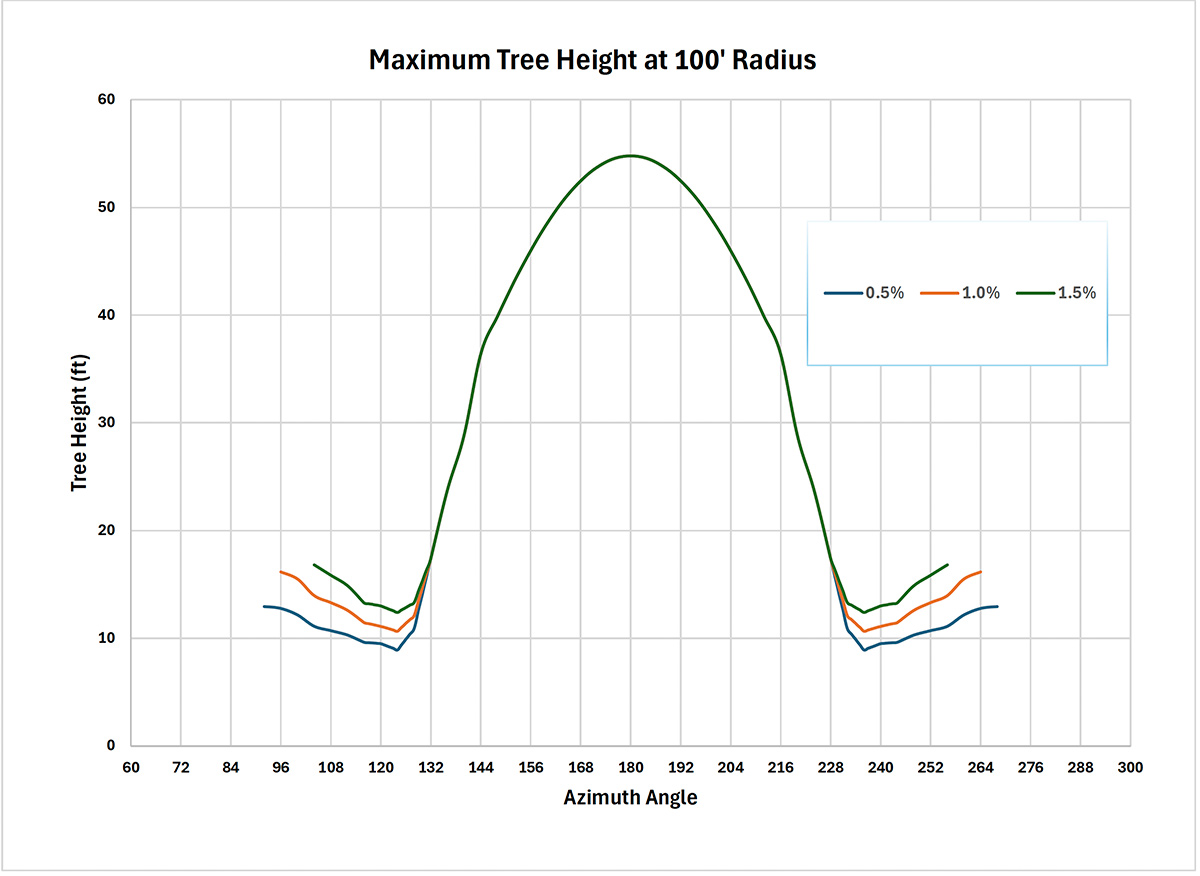

The first step in estimating shade interference is to determine the solar declination angle (angle between the sun’s rays and the Earth’s equatorial plane), solar altitude angle (angle of the sun’s center above the horizontal plane), and azimuth angle (horizontal direction of the Sun) at regular time intervals for every day of the year. The solar altitude angle determines the length of a shadow while the azimuth angle determines the direction of the shadow. Geographic tools with these angles are readily available on the internet. Suncalc.org, for example, has map imagery and a calculator to visualize where shadows will be cast throughout the year. System designers use more powerful tools like Aurora and Helioscope to optimize siting.
The sun azimuth angle for incremental combinations of solar declination angle (day of the year) and solar altitude angle (time of day relative to solar noon) for any given latitude is calculated. The graph shows the maximum tree height (defined as the maximum height a tree can be without casting a shadow on the solar array at any time during the year) at a radius of 100’ from the solar array with assumed maximum generation losses of 0.5%, 1.0% and 1.5% (based on relatively low intensity of sun light in early morning and late afternoon hours); the given latitude is 38° N.
Maximum tree heights are determined by a small range of dates centered around the winter solstice for the azimuth angles ranging from approximately 132° to 228° with 180° representing due south which occurs at Solar Noon. As the azimuth angle moves lower from 132° or higher from 228° the controlling day for each respective azimuth angle moves from the winter solstice to the summer solstice. Tree heights controlled by the winter solstice reflect days where solar altitude angles are not large enough to clear a tree taller than these limits. This shading from trees and buildings when the sun is at low angles doesn’t actually impact total production very much because the sun is at such a great angle to the plane of the solar array that there would be very little energy generation at that time period even if the trees or buildings were absent. Maximum tree heights for azimuth angles not associated with the winter solstice are dictated by the shallow solar altitude angles that occur in the early morning and late afternoon periods of the day.
A simple way to interpret/use this chart is to assume generation losses will not be exceeded if the surrounding tree/structure profile for the entire range of azimuth angles is below its relevant height limit. Areas where trees/structures are less than the maximum would reduce this annual loss estimate. Perhaps it goes without saying but height limits are proportional to the distance from the solar array.

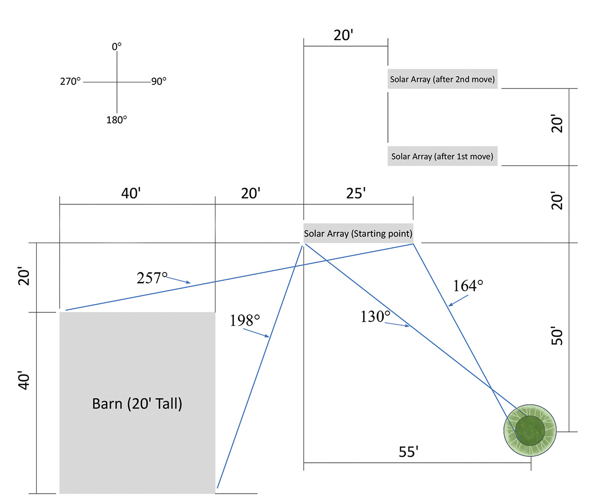

The profile of any object can be defined by a series of combinations of azimuth angles and solar altitude angles. The potential for shading begins when the angle between the object and the western end of the array matches the azimuth angle. As the day wears on, the azimuth angle works its way west to east along the array. Shading ends when the angle between the object and the eastern end of the array matches the azimuth angle.
Trees located closer to due southwest and southeast have a much greater impact on potential generation losses.
Trees located closer to due southwest and southeast have a much greater impact on potential generation losses. © Steve Moss
Within this range of azimuth angles, shading will only occur if the solar altitude angle is less than the vertical angle from the array to the top of the object (defined here as the minimum solar altitude angle). Although the minimum solar altitude angles within the range of azimuth angles can be easily calculated, the amount of the resulting lost generation is a much trickier value to calculate. This is because both the azimuth angle and solar altitude angle behave as a sine wave throughout the year. In addition, the intensity of sunlight is a function of the solar altitude angle; meaning the potential for generating electric power diminishes as the sun gets closer to the horizon.

To determine the potential generation loss of a tree, the distance between the tree and the solar array and the azimuth angle are measured at site. The western end of the solar array is used for both measurements. The azimuth angle can be determined with the compass app on a smart phone by standing at the tree and pointing the phone toward the solar array. The tree height is also estimated (this can be done by someone holding a pole of a known length next to the tree and an observer visually estimating the tree height in terms of the number of pole lengths needed to match the tree’s height). There are, of course, more sophisticated methods of making these measurements.
The tree height, distance to tree, and azimuth angle are entered into a spreadsheet along with the dimensions of the solar array. Azimuth angles and distances to the tree are calculated for the various points along the object’s profiles. These distances are used to determine the minimum solar altitude angle for these various points.
Please refer to the plot sketch for a better understanding of a tree and barn location relative to the solar array. For illustration purposes, the tree’s profile is defined as two concentric cylinders; the first has a 6’ diameter and height equal to the estimated height of the tree; the second has a 12’ diameter and a height 5’ less than the height of the tree. These values can be varied and additional cylinders added, if needed.

Example of a 50’ Tree
For illustration purposes a 50’ tall tree located 55’ east and 50’ south of the western end of the solar array is assumed. The range of affected azimuth angles is 130° to 164° for the 6’ diameter portion and 128° to 167° for the 12’ diameter portion. Minimum solar altitude angle ranges from 34° to 41° for the 6’ diameter portion and 31° to 38° for the 12’ diameter portion. The 12’ diameter minimum solar altitude angles are lower because the assumed height is 5’ lower than for the 6’ diameter portion.
50' tree
This tree will provide an estimated 170 hours of shade and reduce annual generation by about 2.6%. General loss estimates for alternate locations will be discussed in the context of minimizing the total of this tree and a nearby barn later in this article. Note: the 170 hours represent about 3.9% of total hours of sunlight; the difference between this and the loss estimate reflects the lower intensity levels associated with some of the shaded area.
Example: A 20’ tall barn with its northern wall located 20’ south with its eastern wall located 20’ west of the western end of the solar array. All four sides are 40’ long. For simplicity, the orientation of this barn is assumed to be true to the N/E axis. With this barn’s assumed dimensions and location, the associated azimuth angle range is 198° to 257° with the minimum solar altitude angle ranging from 13° to 18°.
This barn would provide an estimated 240 hours of shade and reduce annual generation by about 3.1%. As was the case for the tree example, the estimated loss value is much less than the 5.5% of annual hours where this barn is shading the solar array due to the lower intensity of much of the area affected.
The combined annual generation loss of the tree and barn is about 5.7%. The typical capacity of a 25’-wide array is about 6 kw which would be expected to produce about 8400 kwh’s per year. Applying this loss estimate to the total generation yields annual cost estimates of about $48 based on a value of $0.10 per kwh. Assuming the discount rate equals the inflation rate of electricity, the NPV of this annual cost comes to about $960 based on a 20-year life of the array.
If the array can be moved 20’ to the east and 20’ to the north, estimated generating losses of the barn are reduced about 85% to 0.5% annually while losses tied to the tree are reduced more modestly by about 10% to 2.3%. The losses tied to the tree are reduced by the array shift north but this is almost entirely neutralized by the move east.
Starting at this secondary location and moving the array north by another 20’, losses to the barn and the tree are each reduced to about 0.2%. At this point, the benefit of moving further north may need to be compared to any additional cost or detriment that may be incurred.
