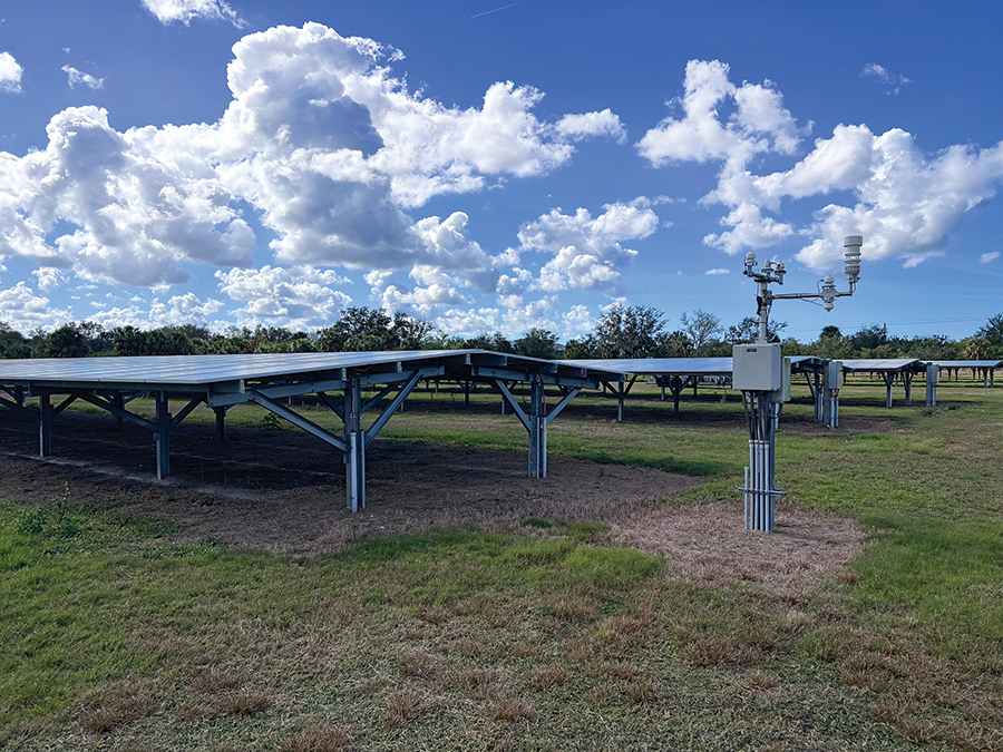

While not optimally positioned, the East-West orientation can allow for the installation of more panels in the same area. © Baker Makarem

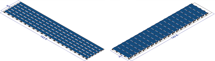

Option A is a conventional design approach that would use a south-facing ballast-mounted system. Using 450-watt modules at a 10° tilt, this surface can accommodate 120 panels, resulting in a 54 kW DC system.
Option B is an E-W configuration using the same 450-watt modules. With an 8° tilt (the same angle used by the same manufacturer for the South example), the same surface can fit 152 panels, for a total of 68.4 kW DC.

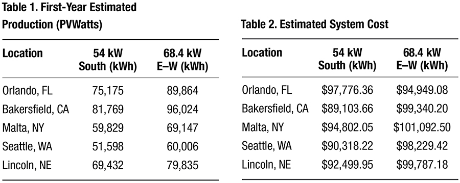

To understand how this plays out, five case studies were evaluated using NREL’s PVWatts tool, assuming a 0.5% annual module degradation rate. The locations were chosen to represent a range of U.S. climates:

As expected, the east–west systems produce more energy in every location, not because they are more efficient per panel, but because they are larger systems on the same roof. Of course, if you can install the same amount of PV modules facing south, you will get higher energy generation than the E-W, but can you install more?

Estimated installed costs were calculated for each system, accounting for typical regional labor rates and site-specific structural requirements.
Structural costs vary by location. High-wind regions, such as Orlando (design wind speeds up to 137 mph), and heavy-snow areas, such as Malta, New York which can reach up to 76 pounds per square feet (psf), increase racking and ballast requirements. These factors affect both layouts, though E-W systems can sometimes distribute loads more efficiently.
Option A (left): South-facing ballast system, tilt angle 10,° 120x450W PV modules. Option B (right): E-W facing ballast system, tilt angle 8,° 152x450W PV modules. © Baker Makarem

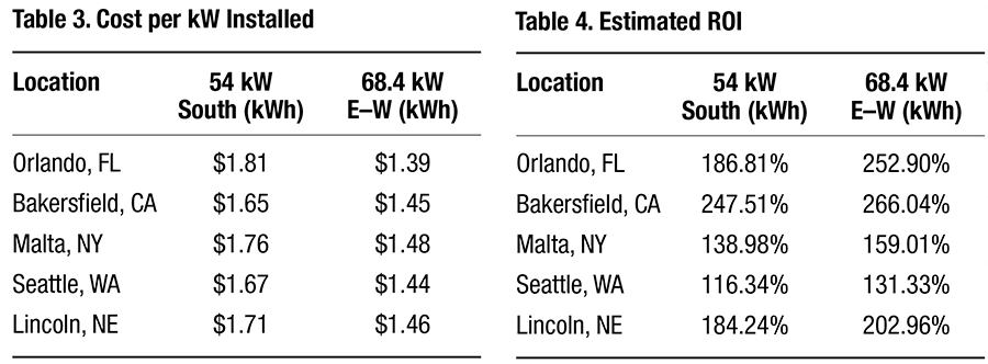

Across these five cases, the east–west configuration averages about 16% lower cost per installed kilowatt than the south-facing layout, with some locations showing differences as low as 23%.

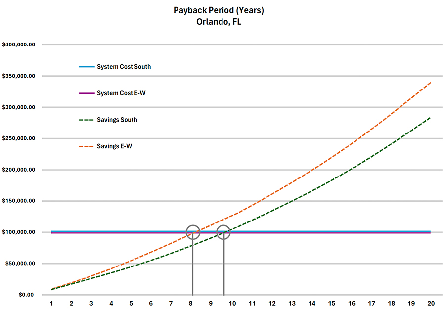

The analysis for the city of Orlando assumes an electricity price of $0.11 per kWh and a 6% annual increase in electricity rates. The east–west system reaches payback sooner than the south-facing system, reflecting its higher production and lower cost per kilowatt.
Payback time in years, Orlando, FL. © Baker Makarem
A shorter payback also leaves more financial margin over the system’s life to cover capital expenses, such as inverter replacements.
Return on Investment (ROI). This is another metric to consider, which measures net savings vs. investment. Across the 5 scenarios, the ROI ranged between 130% to 252%. These values can vary depending on expenses during the 20-year estimated lifespan of the system.
The message is consistent: in these examples, east–west layouts deliver stronger ROI because they install more capacity per roof area and typically do so at a lower cost per kilowatt, with higher energy production, compared to what can be installed facing south.
